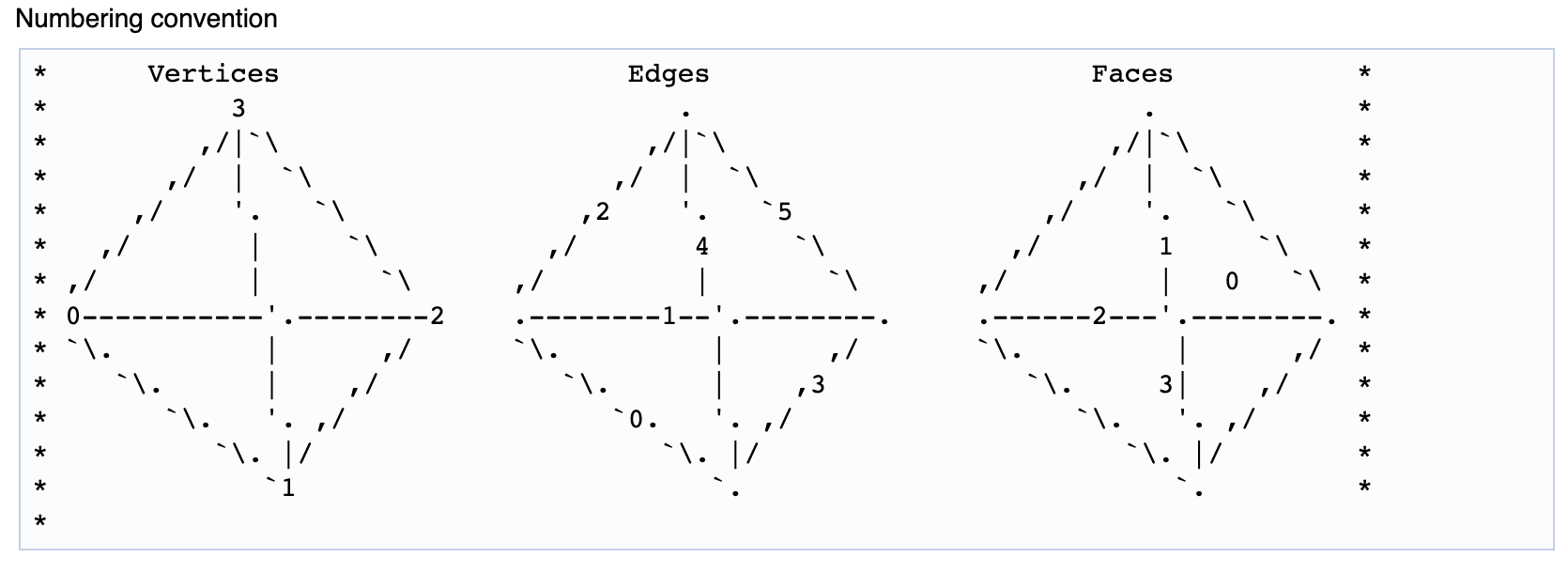

Hi Jay,
Thank you for trying Mmg.
The numbering convention of Mmg is hidden in the Doxygen documentation of the libmmgtypes.h file of the project (the file that contains the description of the Mmg data structures). Normally, you don’t need this information: it is sufficient to give to Mmg the tetra connectivity only (indices of the tetra vertices).
In any case, I will describe first how to use the Doxygen documentation, then I will detail the tetra numbering (so you are not forced to really build the documentation

edges are numbered in the order of their extremities indices:
A face is numbered with the index of its opposite vertex:
